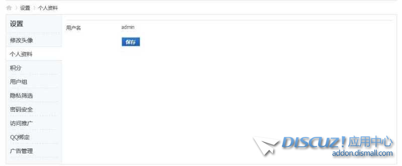

2 discuz个人资料修改空白
解决办法:编码utf8进入后台数据库执行
  1. REPLACE INTO `pre_common_setting` VALUES
  2. ('profilegroup', 'a:5:{s:4:"base";a:4:{s:9:"available";i:1;s:12:"displayorder";i:0;s:5:"title";s:12:"基本资料";s:5:"field";a:17:{s:8:"realname";s:8:"realname";s:6:"gender";s:6:"gender";s:8:"birthday";s:8:"birthday";s:9:"birthcity";s:9:"birthcity";s:10:"residecity";s:10:"residecity";s:10:"residedist";s:10:"residedist";s:15:"affectivestatus";s:15:"affectivestatus";s:10:"lookingfor";s:10:"lookingfor";s:9:"bloodtype";s:9:"bloodtype";s:6:"field1";s:6:"field1";s:6:"field2";s:6:"field2";s:6:"field3";s:6:"field3";s:6:"field4";s:6:"field4";s:6:"field5";s:6:"field5";s:6:"field6";s:6:"field6";s:6:"field7";s:6:"field7";s:6:"field8";s:6:"field8";}}s:7:"contact";a:4:{s:5:"title";s:12:"联系方式";s:9:"available";s:1:"1";s:12:"displayorder";s:1:"1";s:5:"field";a:7:{s:9:"telephone";s:9:"telephone";s:6:"mobile";s:6:"mobile";s:3:"icq";s:3:"icq";s:2:"qq";s:2:"qq";s:5:"yahoo";s:5:"yahoo";s:3:"msn";s:3:"msn";s:6:"taobao";s:6:"taobao";}}s:3:"edu";a:4:{s:9:"available";i:1;s:12:"displayorder";i:2;s:5:"title";s:12:"教育情况";s:5:"field";a:2:{s:14:"graduateschool";s:14:"graduateschool";s:9:"education";s:9:"education";}}s:4:"work";a:4:{s:9:"available";i:1;s:12:"displayorder";i:3;s:5:"title";s:12:"工作情况";s:5:"field";a:4:{s:10:"occupation";s:10:"occupation";s:7:"company";s:7:"company";s:8:"position";s:8:"position";s:7:"revenue";s:7:"revenue";}}s:4:"info";a:4:{s:5:"title";s:12:"个人信息";s:9:"available";s:1:"1";s:12:"displayorder";s:1:"4";s:5:"field";a:10:{s:10:"idcardtype";s:10:"idcardtype";s:6:"idcard";s:6:"idcard";s:7:"address";s:7:"address";s:7:"zipcode";s:7:"zipcode";s:4:"site";s:4:"site";s:3:"bio";s:3:"bio";s:8:"interest";s:8:"interest";s:7:"sightml";s:7:"sightml";s:12:"customstatus";s:12:"customstatus";s:10:"timeoffset";s:10:"timeoffset";}}}');

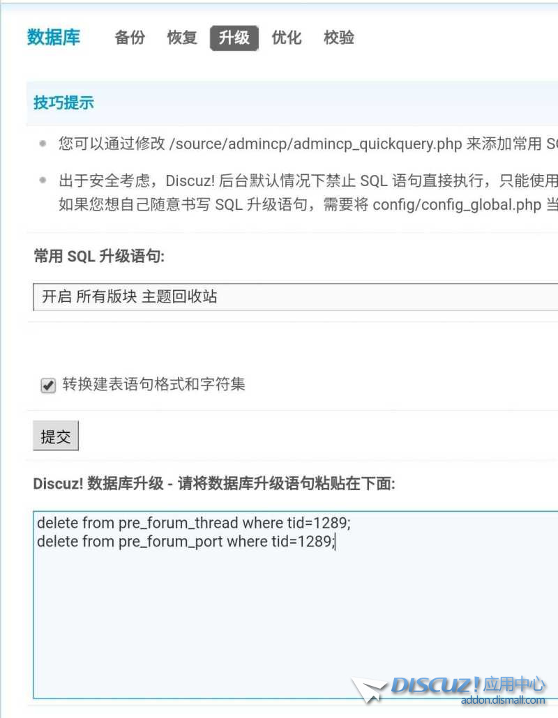

5、帖子已经删除但是搜索中复现的解决办法
后台-数据库-数据升级
1289为帖子uid,按实际修改
  1. delete from pre_forum_thread where tid=1289;
  2. delete from pre_forum_port where tid=1289;
如果没有效果再点下上面的 开启所有版块 主题回收站那个下面的那个提交即可

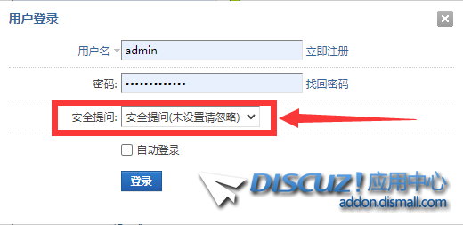

6、删除安全提问
/template/default/member/login.htm
删除 92-118  (代码如有错位请自行对照)
