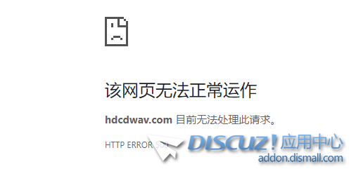

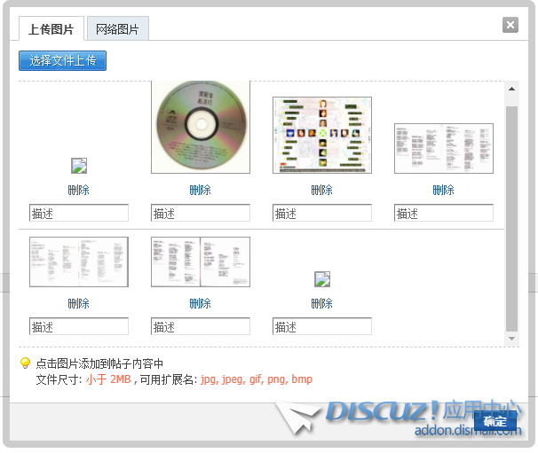

强行插入就提示该网页无法正常运作www.hdcdwav.com 目前无法处理此请求。HTTP ERROR 500,

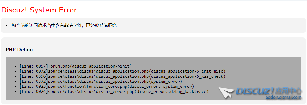

再刷新就出现Discuz! System Error
您当前的访问请求当中含有非法字符,已经被系统拒绝PHP Debug[Line: 0057]forum.php(discuz_application->init)[Line: 0072]source/class/discuz/discuz_application.php(discuz_application->_init_misc)[Line: 0596]source/class/discuz/discuz_application.php(discuz_application->_xss_check)[Line: 0372]source/class/discuz/discuz_application.php(system_error)[Line: 0023]source/function/function_core.php(discuz_error::system_error)[Line: 0024]source/class/discuz/discuz_error.php(discuz_error::debug_backtrace)
但这里可以上传,请假如何解决?
下图是不能上传的图片
